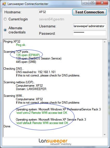

  1. Run the testconnection tool on your Lansweeper server, as it will help in the troubleshooting process. The tool can be found at Program Files (x86)\Lansweeper\Actions\testconnection.exe.
    You must open the test tool on your Lansweeper scanning server, i.e. on the machine that has the Lansweeper Server service installed. Tests initiated from other machines cannot be used for troubleshooting purposes, as they do not replicate the exact network conditions (e.g. firewalls) experienced by Lansweeper.
  2. Run multiple tests in the test tool, connecting to the computer's IP address, NetBIOS name and (in the case of a domain computer) Fully Qualified Domain Name (FQDN).
    When running your tests, submit the same credential that was also submitted in Lansweeper for scanning.
  3. Make sure the DNS section of the tool shows the computer name being resolved to the correct IP address when running tests to the NetBIOS name or FQDN of the computer.
    If there is a DNS issue for instance and connecting to your computer's name returns an incorrect IP address as a result, this will lead to scanning issues. Discuss any DNS issues that may be visible in the test tool with your network admin, as they must be resolved in your network itself.
  4. Look at the Scanning TCP Ports and Scanning WMI sections of the tool to determine whether necessary ports are open for scanning. Lansweeper must have access to TCP port 135 to set up the initial DCOM connection to the client machine, and the random ports that are used by Windows to send WMI data.
