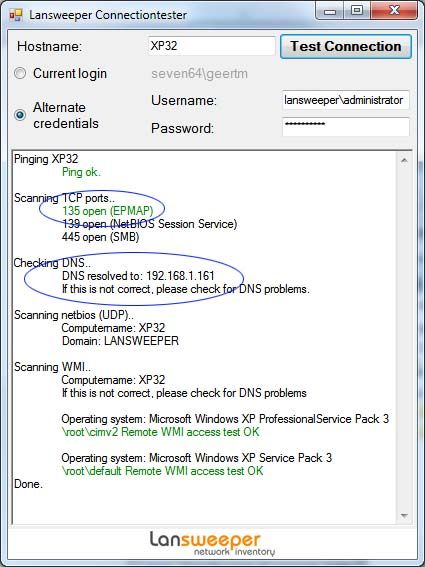

  4. Run the following tool on your Lansweeper server, as it will help in the troubleshooting process: Program Files (x86)\Lansweeper\Actions\testconnection.exe.
    You must open the test tool on your Lansweeper scanning server, i.e. on the machine that has the Lansweeper Server service installed. Tests initiated from other machines cannot be used for troubleshooting purposes, as they do not replicate the exact network conditions (e.g. firewalls) experienced by Lansweeper.
  5. Run multiple tests in the test tool, connecting to the problem computer's IP address, NetBIOS name and (in the case of a domain computer) Fully Qualified Domain Name (FQDN).
    When running your tests, submit the same credential that was also submitted in Lansweeper for scanning.
  6. When running tests to NetBIOS name or FQDN of the computer, make sure the DNS section of the tool shows the computer name being resolved to the correct IP address.
    Based on which scanning method you are using to scan your computer, Lansweeper will try to connect to IP address, NetBIOS name or FQDN. It is important that connecting to either of those properties brings you to the correct client machine. If there is a DNS issue for instance and connecting to your computer's name returns an incorrect IP address as a result, this will lead to scanning issues. Discuss any DNS issues that may be visible in the test tool with your network admin, as they must be resolved in your network itself.testconnectiondns.jpg
  7. Look at the Scanning TCP Ports and Scanning WMI sections of the tool to determine whether necessary ports are open for scanning.
    Lansweeper must have access to TCP port 135 (to set up the initial DCOM connection to the client machine) and the random ports that are used by Windows to send WMI data. Our knowledge base contains firewall configuration instructions for Windows Firewall and Symantec Endpoint Protection. For other third-party firewalls, we recommend consulting the vendor's documentation.testconnectionport.jpg

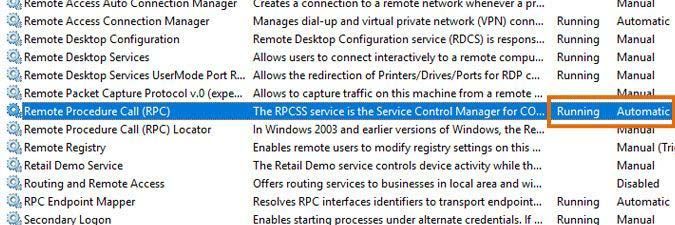

  8. Make sure the RPC service is running on the computer you're trying to scan. By default in Windows, this service is configured to run automatically. It may have been manually stopped, however, resulting in "RPC server unavailable" errors.The-RPC-server-is-unavailable-1.jpg
