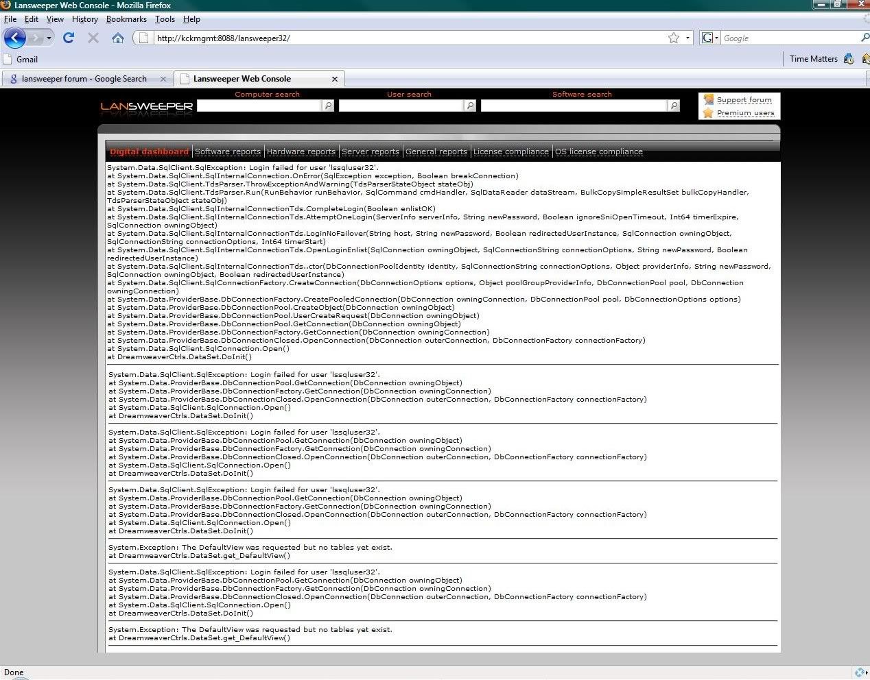

Just got done installing 3.2 on a server 2003 box.
Here is what I get when go there. Note: we changed lansweeper to use port 8088

ja3hawk
Yea I changed it in sqlexpress and in the config file? Should I have left it alone?
EDIT: okay I didnt realize that the credentials needed changed in that config file as well. That worked! Thank you guys. I will be buying premium membership once I get it rolled out and confirm that it will meet our needs.
Thanks Again.
Hemoco
Lansweeper Alumni
You can check the login and password for your database in the web.config file.
Did you chan ge the password on your database server?
