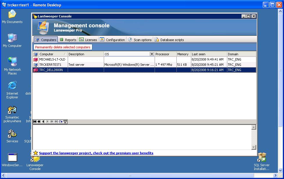

I setup LS yesterday and have it set through logon scripts to the lsclient.
The service is running with a user account that has network admin rights - and it scanned the host computer perfectly.
Now I'm trying to scan other computers and I see the computer name on the list in the console but they are in red with no further information.
I've run the connection tester from the other computers and there is no issue by short name, long name or IP. Here is one result:
Ping test OK
Remote registry test OK
Remote WMI access test OK
Remote \\[servername]\c$ access test OK
Any assistance would be greatly appreciated.

‎08-20-2008 07:02 PM
Thanks for such a quick response!
I did run the client on the computer I want scan - from the logon script. I went ahead and ran it manually again and it runs fine. I get the "Connecting....Success" message. When I go back to the console the machine is still in red with no info other than the client computer name. I don't see an "Errors" tab in the Console.
My 'errors.txt' file contains:
8/19/2008 1:25:47 PM : Database connection successful, starting up service
8/20/2008 9:15:56 PM : Stopping service
8/20/2008 9:16:00 PM : Database connection successful, starting up service
That's it. And the stop and start today were when I changed the service logon to be THE enterprise admin account for the AD just to make sure there were no problems with permissions.
I tried adding a screenshot so you can see what I mean, but I can figure that out either. Today just may not be my day for troubleshooting errors...staying up too late with the Olympics lately. 🙂
bvinson
bvinson
