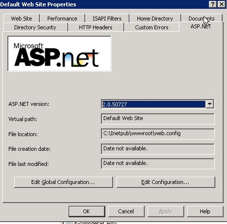

The Lansweeper setup went fine. I had to install SQL express, dotnet and add IIS to a bare server. I added a logon script to the netlogon folder and configured AD to execute this during logon. From the configuration console I can see machines populating the database. When I try to open the Lansweeper website it fails with a 404 error, page or directory cannot be found.
I installed lansweeper website as the default website and have no other websites on the box.

Had to enable ASP.net to run on the site. Works fine now

lleddac
I posted a few screen shots,
Let me know if you need more.
Thank you,
Bob
