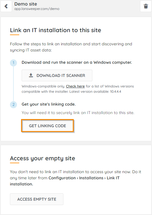

  4. Select Get linking code to be redirected to your new Cloud site.
    The linking code was introduced in Lansweeper 10.5. You will need to update your installation if you are running a lower Lansweeper version.

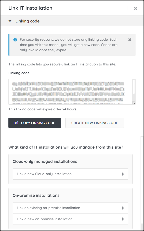

    If you selected Access empty site instead, you can get your linking code from your Cloud site by going to Configuration > Installations > Link IT Installation.
  5. In the pop-up, select Copy linking code. You will need to enter this code in your local web console later.
