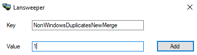

  • In the Service tab, click Add under AppSettings.
  • Enter NonWindowsDuplicatesNewMerge with a value of 1 and hit Add.
NewMergeLogicNewMergeLogic
  • Hit Save configs and restart service and confirm by hitting Yes in the window that pops up.
