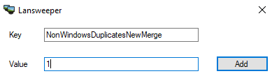

However, you can enable the new merging logic as follows:
  • First, ensure that your Lansweeper installation is up to date.
    • Before updating, create a backup of your installation, just to be safe.
  • Go to Program Files (x86)\Lansweeper\Tools on your Lansweeper server and run ConfigEditor.exe.
  • In the Service tab, click Add under AppSettings.
  • Enter NonWindowsDuplicatesNewMerge with a value of 1 and hit Add.
NewMergeLogicNewMergeLogic
  • Hit Save configs and restart service and confirm by hitting Yes in the window that pops up.
  • Rescan the IP range(s) containing the non-Windows assets that were merging.
  • Check if asset pages were created for the devices in the scanned range(s) that were previously being merged into other devices.

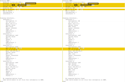

Hi David, looks like the tool supports snmpv3 as well, as it offers the options to change to it and setup the credentials,
I have the compare for 2 devices that are overwriting
Screenshot attached, hope you can work out what is causing the merge
Thanks, Adri
