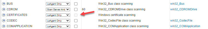

Hi all,
I'm using Lansweeper v.10.4.1.0.  I referenced this other forum post from 09-20-2022 by Lansweeper Tech Support that acknowledged that Windows certificate scanning times are an issue.
However, our checkbox for CERTIFICATES, under Scanned Item Interval, is already unchecked.  In fact, it's grayed out and it's not checkable or uncheckable.
Let's presume that this is still an issue and that Lansweeper is working on a fix referred to as LAN-14049 in their changelog as indicated by the 09-20-2022 post.
Why is that CERTIFICATES checkbox uncheckable?
Thanks much,
Tom.

I have been having this issue since the upgrade to 10.3 as well. Other Lansweeper tech support employees have indicated this is only an issue during manual scans, which is true for me. I have certificate scanning completely disabled under Scanning > Scanned Item Interval.
One of the Lansweeper employees said they have identified the issue which seems to be during manual scans, the settings are ignored and everything gets scanned thus causing certificates to be scanned.
This is a very disappointing problem as my organization uses manual scans multiple times per day. Being that this issue has been going on for six months with no fix makes it hard for me to want to stick with Lansweeper as a customer. This causes quite a bit of headaches for me.

I just updated to the most recent version of Lansweeper (v10.4.2.4) and it appears some changes have been made to the certificate scanning.
My manual scan times for certificates went from ~600 seconds to ~150 seconds which is an improvement but does not address the fact that I have certificate scanning disabled in the Scanned Item Interval page. Apparently, manual scans disregard the scanned item settings even though the most recent update added new options to completely exclude certain items from being scanned.
@Lansweeper thank you for addressing the certificate scanning times but please address the issue of manual scans disregarding the settings which still allow certain items to be excluded from scans totally.

The latest release (10.4.2.4) indeed contained a performance fix for certificate scanning, and our development team is actively looking into fixing the other issue so that scan items are excluded from manual scans as well.
