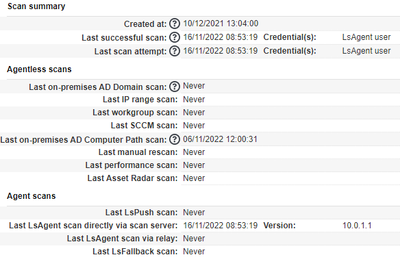

All clients have the latest LSAgent version installed (10.0.1.1) and are generally sending scan information every 4 hours (default setting). I made a chart report to check the percentage of users that are using the tunnel:
The LSAgent on the client is generally able to contact the Lansweeper Server over LAN as well as via the Tunnel interface so I can rule out network connectivity issues.

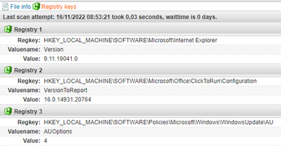

The LSAgent Service on the clients is reporting those custom registry scan values just fine but every now and then some clients are missing those registry values on their asset page even if the values are set on the client (which I verified on site):
When forcing a client rescan using the LSPush.exe as the logged on user on the client the registry key values are updated in Lansweeper immediately.
It looks to me as if the LSAgent Service (Which is running as local System) sometimes can not read the User Registry.
Is it possible that if the client is locked (lunchbreak etc.) the LSAgent Scan is not able to read the logged on User Registry.
My main problem is that I would need a relatively current status of the registry key and therefore I set the custom registry interval to "0" (update on every scan) which now causes the registry value to vanish on the asset page when the LSAgent on the client can not read the logged on User Registry.

Hello @plausability, the error you are getting might be related to accessing the HKEY_CURRENT_USER while running the scanning agent as a local system since it might not have access to the same keys.

I agree with j_diaz - i think its due to the service running as SYSTEM. If you want to see if it works when a user is logged on, you can follow these instructions: https://community.lansweeper.com/t5/forum/lsagent-force-a-scan/m-p/42431#:~:text=If%20you%20want%20t....
just dont forget to revert the file change.
