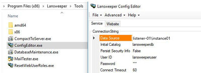

  • Run the ConfigEditor tool, found at on the servers hosting your Lansweeper Server service and web console.
    In data source field provide availabilitygroup listener name with instance name, in our example
    listener-01\instance01.
    In password field, provide password provided in user account creation.
