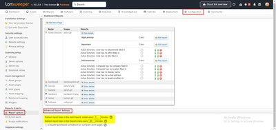

Actually I noticed when all reports is updating it makes the server run extremely slow. I cannot seem to find when this is scheduled. I am assuming it happens constantly through out the day?
Obi_1_Cinobi
Hello there!
The refresh intervals for reports can be found under Configuration\Report Options in the Advanced Report Settings section.
