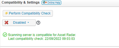

  • Asset radar: Set asset radar to disabled under Scanning\Compatibility & Settings.
Performance scanning was already disabled, we tried to disable Asset Radar, restart the service and try again, but the queue still stuck...
