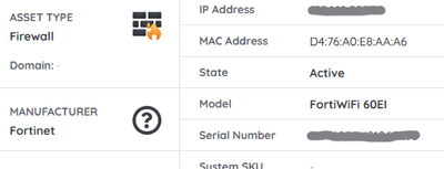

I recently discovered that some of our newer Fortigate firewalls (Fortigate 60F) were being incorrectly identified as FortiWifi devices in both Lansweeper Classic and Sites. Discovery is being provided solely via the on-prem install, and I was able to re-identify via the OID mapping there. However, despite ensuring the data had been rescanned and resync'd to the cloud site, the devices continue to be incorrectly identified on the cloud side. And I haven't found any way to correct them there.

As for your final statement, that unfortunately is not the case. I have updated this information in our Lansweeper Classic deployment, and it does show up correctly there. Unfortunately, the same assets continue to be mis-identified in Lansweeper Sites.
Fortigate 60F in Lansweeper Site:
Fortigate 60F in Lansweeper Classic:
