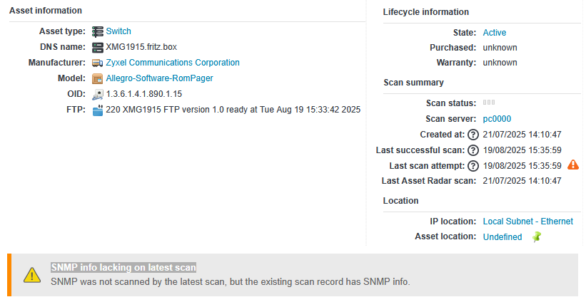

Hi there,
I see this:
So, was the last scan ok (Last successful scan=now) or not (Red sign at lasst scan attempt)

Hey MySSV -
That usually means that SNMP once or used to work, but the latest scan it didn't.  Example:  I have a network device at home where the SNMP service on it kept crashing.  Once I restarted the service, it would scan and the error would go away, until I fixed it in general.  There's a tool included that can test SNMP, details here:  Troubleshoot SNMP scanning issues - Lansweeper Community

myssv
I found the solution at the switch. There was an option to de/activate SNMP .....

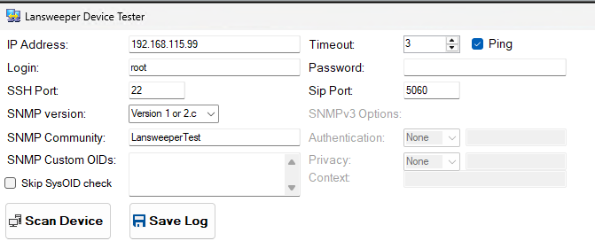

myssv
Hi Jacob,
thanks for your respond. I tested it with the Device Tester an got this result:

I don't know what could be the problem, as it worked before.

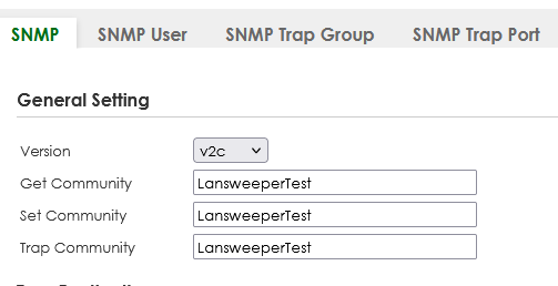

SNMP Setting of the switch
What can I do?
