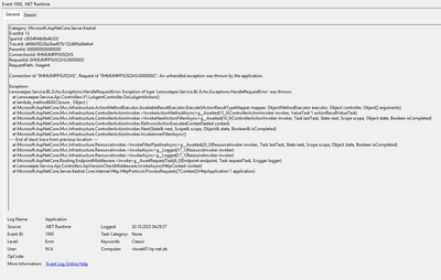

10-30-2023 08:55 AM - edited 10-30-2023 08:56 AM
When I start a manual scan of my vCenter Server my windows eventlog is filling with errors related to that job:
The first error in detail:
And I also have hundreds of .net errors that are lsagent related:
