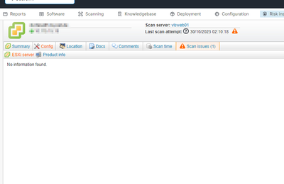

Since the update to v11.1.1.3 my VMware vCenter Server is not scanned anylonger.
It also no longer shows up as an asset.
Before the update all was OK. The vCenter and all scanned information was there.
We upgraded from v10.6.2.0
Scanning credentials are OK.
I have the vCenter IP with credentials as scanning target to scan it manually.
I can trigger the scan manually, the IP shows up in the scanning queue but seems not to be scanned because the vCenter server does not show up as asset and the widget stays empty.

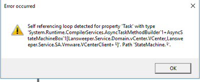

Please scan vCenter via
"c:\Program Files (x86)\Lansweeper\Service\Lansweeper.TestTools.App.exe"
Thanks.
That tool immediately throws an error when trying to scan the vcenter:

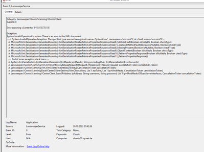

When I start a manual scan of my vCenter Server my windows eventlog is filling with errors related to that job:
The first error in detail:

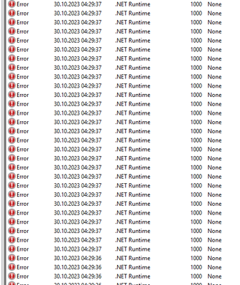

And I also have hundreds of .net errors that are lsagent related:
