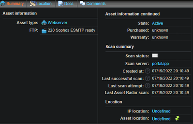

On our asset list we have around 50 of these "webservers" with almost no information, I am not sure what lansweeper is looking at to get the info or where it comes from. They look like this:

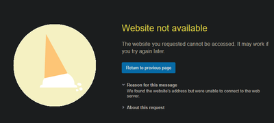

When I visit the associated IP address, it goes to this generic Sophos screen:
We use a Sophos firewall and have Sophos clients installed on each computer, and the ESMTP makes me think it's something do with how our Sophos filters emails, but I don't really have much else to go on. I would love if someone could direct me on how to get some more information on these "webservers."

It looks like this person had the same issue scanning on a network with a Sophos firewall:
Scanning a public IP shows me my own firewall's information : nmap (reddit.com)
The firewall is acting as an email proxy to ensure all outbound email is scanned. This person disabled the proxy on the firewall to resolve the issue but if you're relying on that for email filtering I would recommend creating exceptions in Lansweeper instead.

From your screencap, I'd guess that the device is being identified as a web server because it's running an FTP server. When you try to visit the IP address, you're likely using a web browser and trying to connect to an HTTP server, which the device isn't running, so it's no surprise you can't connect. Try using an FTP client and you should get a response. (If you can't do it from the command line, grab a copy of Filezilla.)
08-18-2022 06:21 PM - edited 08-18-2022 06:35 PM
Update, I wasn't able to connect to an ftp server through filezilla or cmd, the connection just times out every time. Thanks for the suggestion
