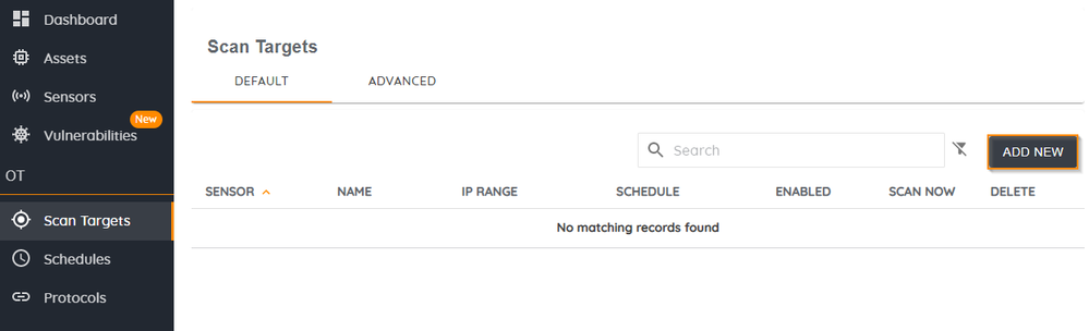

Scan your OT from Lansweeper On-premises
Once you've set up your installation, you can start scanning your network. Use the Lansweeper Network Discovery Hub shortcut on your desktop to access the OT interface and select Built-in Admin Login to log in.
Default flow
  1. On the Scan Targets page, select Default to view your default scan targets.
  2. Select Add New to create a new, default scan target.
  3. Optionally, if you have linked multiple sensors, select a sensor.
    A default OT installation will only have one sensor. This field will only be visible if multiple sensors have been linked.
  4. Enter a unique name for the new scan target.
  5. Select the IP range you want to scan.
    Lansweeper OT will automatically detect the network ranges based on information from the network interfaces linked to the selected sensor. If you want to change the proposed IP range, edit the IP range in the Scan Targets page.
  6. Select a scan schedule. You can create custom scan schedules in the Schedules menu.
  7. Optionally, you can enable or disable the scan target.
  8. Select Save
