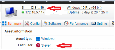

I'd start with the built-in report: Assets: Asset to User relations.
Key in on the RelationType column (Used By) and see the answer in the RelationUser column.
The rest can be removed as you see fit.
