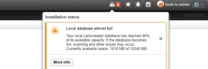

When the database reaches the size limit of 90% a notification will be shown in the on-prem web console.
This notification will only be shown to users that have the Access Configuration permission. The notification can be dismissed, and it will automatically disappear if the database size issue is resolved.
