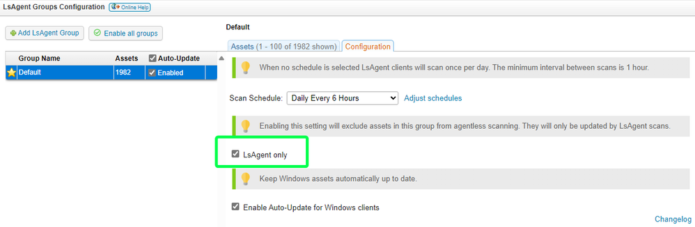

‎05-17-2024 08:50 AM
I'm starting to come to the same conclusion, that there is no easy way of doing this.
And redesigning IP subnet for all different location is not feasible.
At the moment we're dealing with this by setting 'Ignore Windows' on every 'IP Range' -Scan Target in combination with setting the option 'LsAgent Only' in the LsAgent Configuration.
This seems to reduce agent-less scanning to a minimum, but not 0.

‎05-17-2024 08:19 PM
Good find. I've not upgraded to the latest yet so I didn't see the option you highlighted.
Maybe a feature request could be setup for a future version.
Best of luck @jweyts .

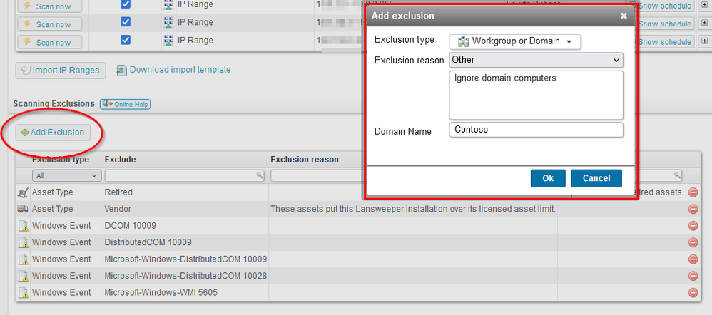

‎05-14-2024 04:36 PM
Another thought is to add an exclusion like this.

‎05-15-2024 09:18 AM
I thought about this option, but it looks like Windows machines will still get scanned but the results are ignored.
Maybe to clarify what I want to achieve is: I don't want lansweeper to use agent-less scanning for Windows boxes ever.
But still want the Windows info from LsAgent scans.
From the Lansweeper documentation:
"If an excluded asset is part of a scanning target, the asset will still be scanned but the data will be ignored as the exclusion has priority over the scanning target."
Exclude assets from scanning - Lansweeper Community

‎05-15-2024 09:12 AM
indeed, that option will not work, I still want to scan non-windows machines.
