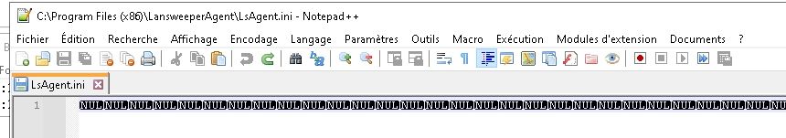

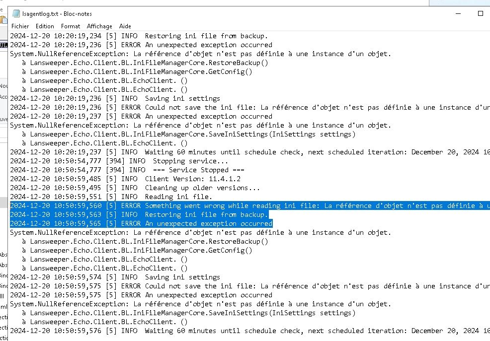

I found a problematic LsAgent client on a PC in the AD domain, because I haven't had any scan updates for 3 days, and when I checked its file C:\Program Files (x86)\LansweeperAgent\lsagentlog.txt , it said there was an error reading the ini file, and it "restored" something, but if I open the LsAgent.ini file, there are only the characters NUL..
do you know why?

I'm running into the same issue with a previous version of lsagent (v11.1.10.0), but I'm discovering this on a multitude of devices (probably 300-ish). Either the lsagent.ini file is corrupt or, worse, it AND the lsagentconfiguration.xml file are corrupt. The first can be fixed by deleting it and restarting the service, but it appears the agent HAS to have some readable version of lsagentconfiguration.xml to do anything. My only solution thus far has been to copy a known good copy from another device.
