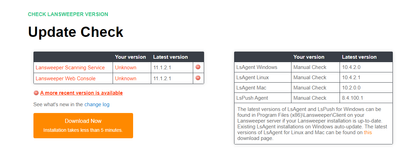

 LS 11121:
Exception(s) while trying to scan Esxi: Error during ESXi scanning: Object of type 'System.String' cannot be converted to type 'Lansweeper.VCenterScanning.Vim.Model.NetIpConfigInfo'.
So scanning ESXi and vCenter is still broken in the current release 11.1.2.1!?
Seems they rushed something out.
Change log is still empty:
https://www.lansweeper.com/changelog/
But the download page has the new version:
https://www.lansweeper.com/update-lansweeper/
