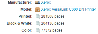

So long as the printer asset page pulls that info (like this):

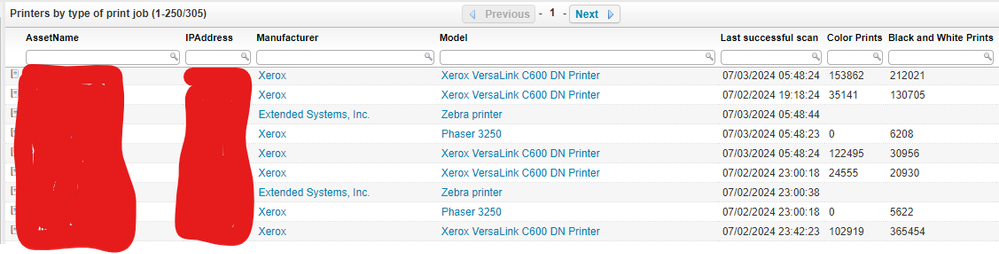

Then the report should work.  Lemme know if it doesnt.  Final report appearence:printer2.png
If your printer models dont pull that info via SNMP, it might require some additional OID/MIB info.
