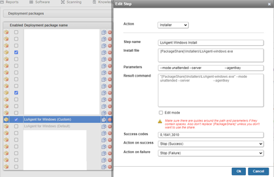

We use the normal {Package Share} \ Installers for most deployments. In this particular example of deploying to my own desktop it didn't require a share since the Action on the first step was MSIUninstaller.
