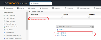

I'm a newbie so I'm not familiar with it. I modified it myself and added a line, but the query showed no results. Did I add the wrong place or parameters? Thanks
Select Top 1000000 tsysIPLocations.IPLocation,
tsysIPLocations.Realstart,
tsysIPLocations.Realend,
(Select Distinct COUNT(*)
From tblAssets Inner Join tblAssetCustom On tblAssets.AssetID =
tblAssetCustom.AssetID
Where tblAssetCustom.State = 1 And tblAssets.IPNumeric >=
tsysIPLocations.StartIP And tblAssets.IPNumeric <= tsysIPLocations.EndIP)
As TotalAssets
From tsysIPLocations
Where tsysIPLocations.IPLocation In ('台中后科廠11', '台中后科廠22')
Order By TotalAssets
- Mark as New

09-21-2023 05:29 AM
Try hint
Where tsysIPLocations.IPLocation In (N'台中后科廠11', N'台中后科廠22')

HI Mister_Nobody,
Thank you. This line of CODE is valid and can be queried. I would like to ask how to modify this REPORT so that the result of the query is only the computer assets of CFP Active Directory Domains? Thanks
