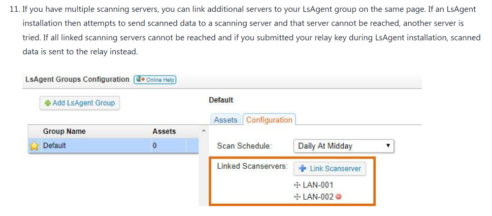

Hello Thibo & co. Regarding the "multiple scanning servers" section of your reply, point #11 on this article (Installing LsAgent on a Windows computer - Scanning your network - Lansweeper Community) describes this.
However, I am left uncertain about how this works. I am setting up a new Lansweeper installation (new customer) and I have considered using a round-robin DNS record for the --server parameter when doing my silent LsAgent installation. If this unnecessary if multiple scan servers are set up and the LsAgent groups are configured correctly?
If unnecessary, how does a client running LsAgent have awareness of the other scan servers that were not defined in its --server parameter (from when it was originally installed?)
Example:
Scan server #1 = LSscan1.domain.com
Scan server #2 = LSscan2.domain.com
LsAgent on workstation1 was installed with --server LSscan1.domain.com
If LSscan1.domain.com is down, how does the client know of the existence of LSscan2?
Thanks!

‎04-06-2023 08:32 PM
I worked with Lansweeper support and received a resolution for my questions. Here is the answer to my questions from the previous reply:
When an asset with LsAgent installed on it does it's first check-in, wether directly to the scanserver or to the Cloud Relay, it will download the configuration and create a file in the Program Files (x86)\LansweeperAgent folder called lsagentconfiguration.xml. In this XML file will be your scanservers that you have configured, along with the relay key for your Cloud Relay, and this file is updated everytime that the LsAgent service connects to your scanservers or Cloud Relay. The end result of this is that your assets, when they connect, will be aware of your configuration and where to send their scanfiles every time.
