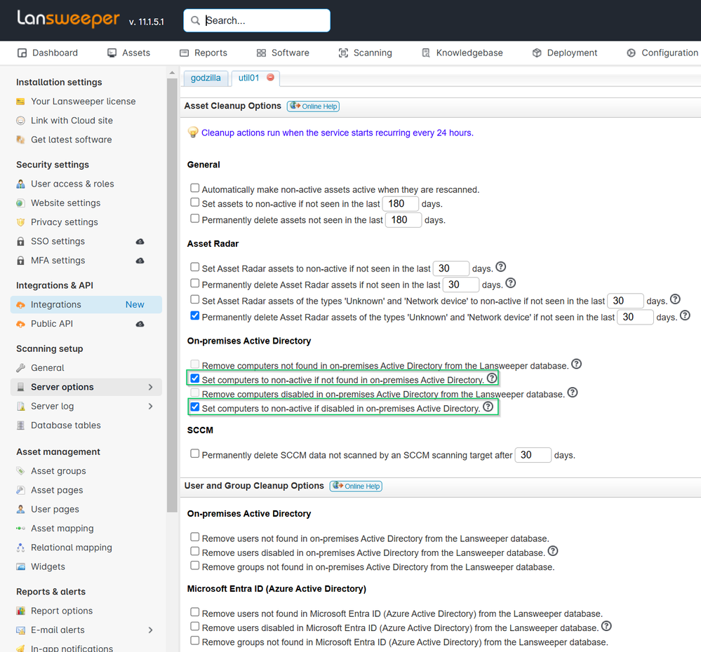

Hey  Keels -  I'm not official support but you can adjust your cleanup options and set assets no longer found in AD to 'inactive'  which is what I do as, like you, i will never delete a legit asset - you can find this in your server options for on-prem in the below image.  We don't store that computer attribute unfortunately but if you use the cleanup-to-inactive, along with Active Scanning (which queries the domain controller to get the objects that have indeed authenticated to the domain controller to scan) - in conjunction with lasttried/lastseen, you should get a good foundation to go further in finding old resources.
