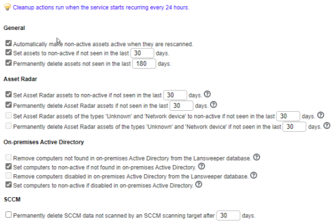

Totally agree. But I think that 'unscannable' servers (for whatever reason) should not vanish without a reason.
> Another reason for them to disappear could be a cleanup option that deletes assets not seen in XX days.
> Stale DNS records or bad DNS resolution can also cause similar issues.
Sure. I checked DNS and the computers can be resolved. The cleanup options are default:
So I would not expect the discovered servers to be deleted that quickly. Having said that, we've installed an LsAgent to overcome this issue and that's a workaround with which we can live.

If assets don't get scanned correctly or completely, you could experience wrong merges to happen. Which could explain why they disappear.
But if they do get rescanned when not available, it could be that they are in AD, and you are also scanning disabled computers in AD, which is an option you can disable.
In the case you logged, it seems that you are running a version that is slightly older. Please try to update to the latest version as well.
