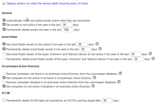

Sure. I checked DNS and the computers can be resolved. The cleanup options are default:
So I would not expect the discovered servers to be deleted that quickly. Having said that, we've installed an LsAgent to overcome this issue and that's a workaround with which we can live.
