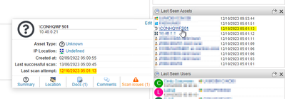

As I was doing my normal Monday morning quick once over, I noticed that the Last Seen Assets" is listing assets that are Non-Active. Is this the norm or is something amiss?

The Last Seen Assets widget indeed takes into account when there was a last scan attempt (see screenshot below of a test environment). If you want to show just the successfully scanned assets, we recommend building a custom report.

The assets I'm looking at in the last seen have a "Last successful scan of 02/19/2019" or some other date, with a "Last scan attempt" with a current date. So it is trying to scan them and not being successful, but listing them in the Last Seen with a current date even though the asset hasn't been on line in some time. Is this the norm?
