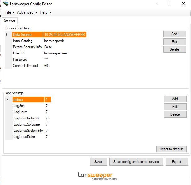

I have installed LSAgent and still there is no Sophos visible in list of installed software. Machine has CentOS Linux 7 installed.
I have also enabled Debug and add mentioned app keys.
ConfigEditorConfigEditor
I'm using admin user with SSH key to login to machine. This user do not require SUDO password. However it seams it cannot read /opt/sophos-spl folder. I'm assuming that there is the issue. Below are peace of log.

In Log file I also don't see label LogLinuxSoftware. Have I configure ConfigEditor correctly ?
