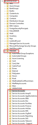

I attached what I see in AD.  I'm not an AD expert so how would I figure out the ou?
change filter to this
Where (tblADusers.OU Like N'%Service Accounts%')

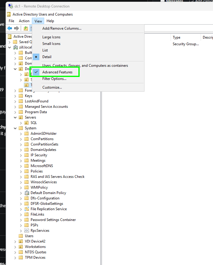

Jacob_H
Ah - to answer your OU question - in Active Directory Users and Computers (ADUAC)  >  to go 'view' > and enable 'advanced features'   Then right-click on the folder (OU) that you want to know about, go to 'properties' and then 'attribute editor'  >  the OU is in 'distinguishedName' attribute. 2025-07-17 09_40_32-dc1 - Remote Desktop Connection.png2025-07-17 09_41_25-dc1 - Remote Desktop Connection.png2025-07-17 09_42_33-dc1 - Remote Desktop Connection.png

Jacob_H
