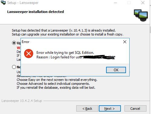

When trying to install the new update i get an error that it cannot get the SQL edition altho the SQL server is not in my LS server.
i cannot login directly to the SQL server itself only to the specific DB using SQL credentials.
how can i fix it?
Please see error below.

If you are still facing issues, we have released a new build to work around the issues.
Thanks, the update is working for me.

I got this error as well, I had to run the installer as a domain admin with higher privileges for it to work.
We had a separate permissions issue around AD/SQL, I thought they might be related. But if others are getting this as well, maybe there is something different in this installer compared to previous ones.
If you haven't already, I would create a case with Lansweeper support.
