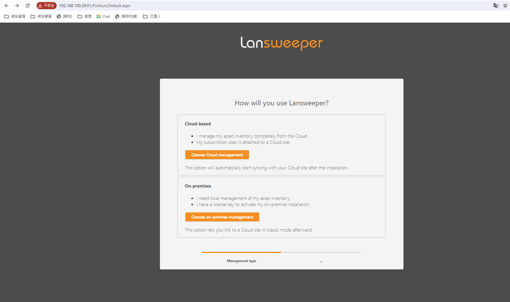

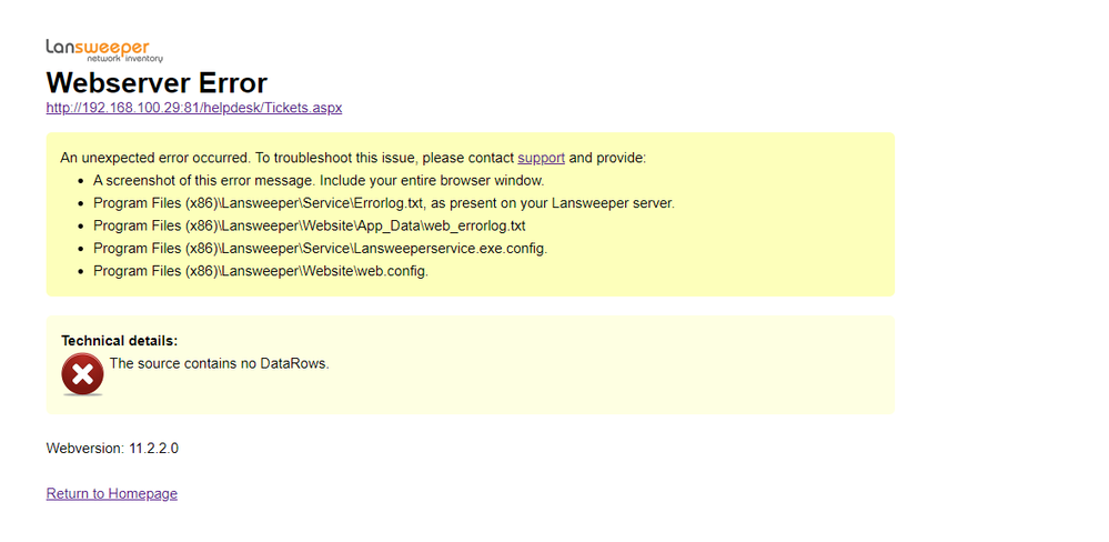

I try to migrate the lansweeper on windows 2012R2 to windows 2019
I refer the information as below website
the lansweeper the can work after restore the database.
But after I restart the database service or restart the windows. the lansweeper have problem. I try to action many times. When I login the lansweeper, the web page show update in progress. and then the web show 2 situation as below 2 pictures. I attach the log that output by "GatherLogs.exe"

Hello,
Looking at the screenshot and your logs, it seems that your website version is 11.2.2.0, while the scanning service is on 11.4.
We think the backup and restore steps mentioned in the article are not correctly followed. Could you please review it?

‎08-28-2024 06:00 AM
sorry I may not provide exactly reference.
originally,my lansweeper version is 11.2.2
I install the same version at the new server windows 2019. the server is used for WSUS.
show error situation. and I try to upgrade the lansweeper at original server. and then install lansweeper 11.4
the situation the same
I restore the database refer the web link as below
https://community.lansweeper.com/t5/lansweeper-maintenance/restore-your-installation-from-a-backup/t...

‎05-07-2025 01:19 PM
Dear,
If you are restoring a SQL LocalDB database, make sure the database files are restored under the SQLDATA folder in the Lansweeper folder structure. If that is not the case, your installation will start a new empty database.
If you are sure you did this correctly, I believe it would be useful to open a Support case for this.
The support team will be able to verify the logs and see what went wrong.

‎08-28-2024 10:05 AM
I try to install a brand new windows 2019.
And migrate the lansweeper to the new system. the problem does not happen.
how do I do find the problem?
Perhaps, there are some factors the effect the the action of restore database.
